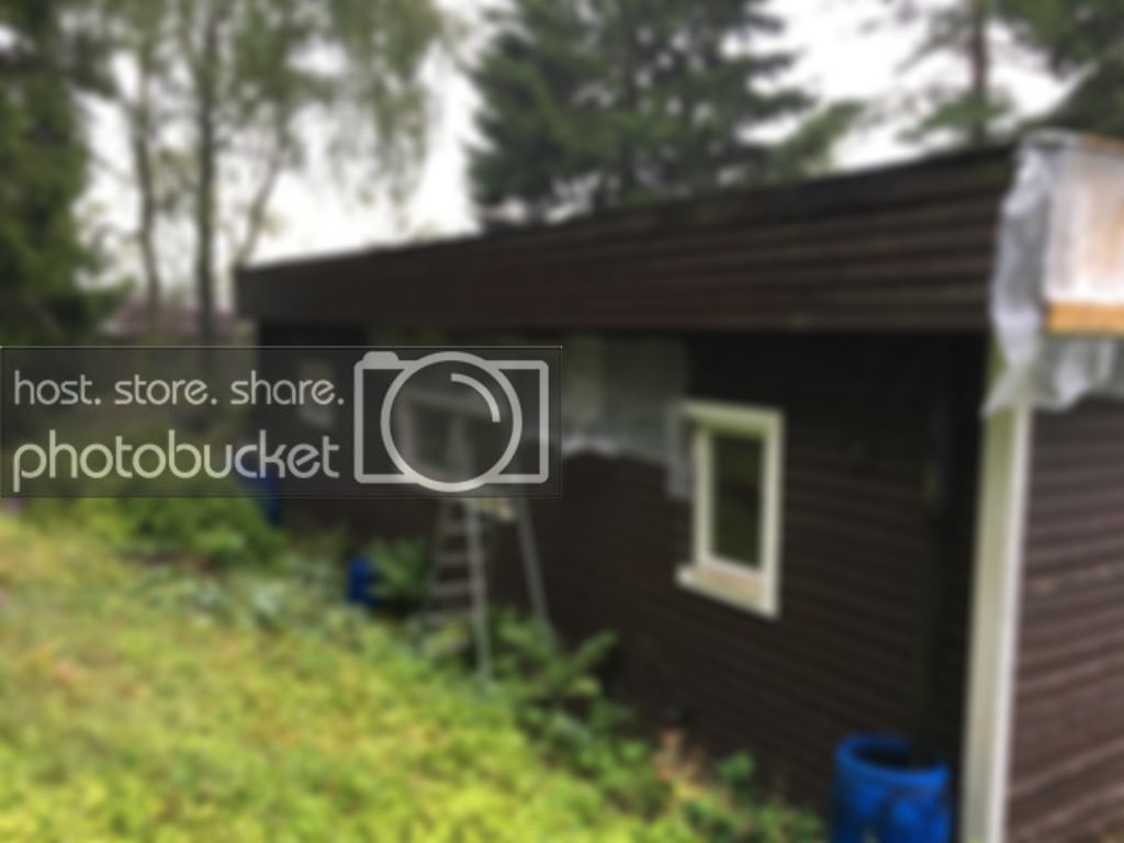

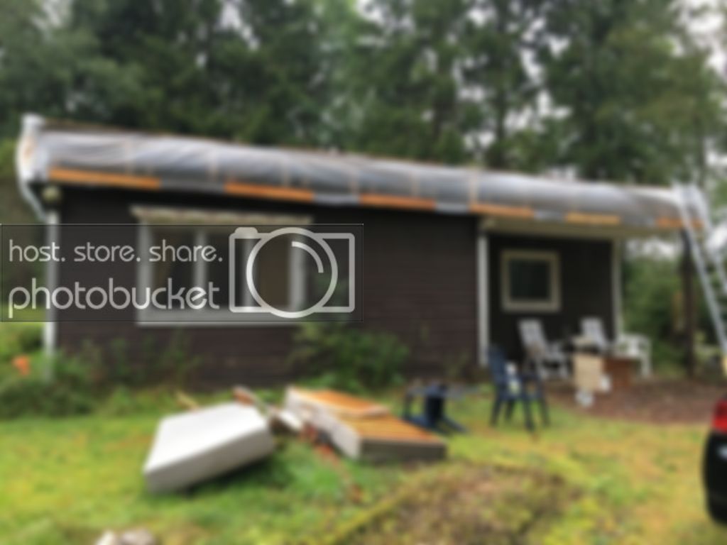

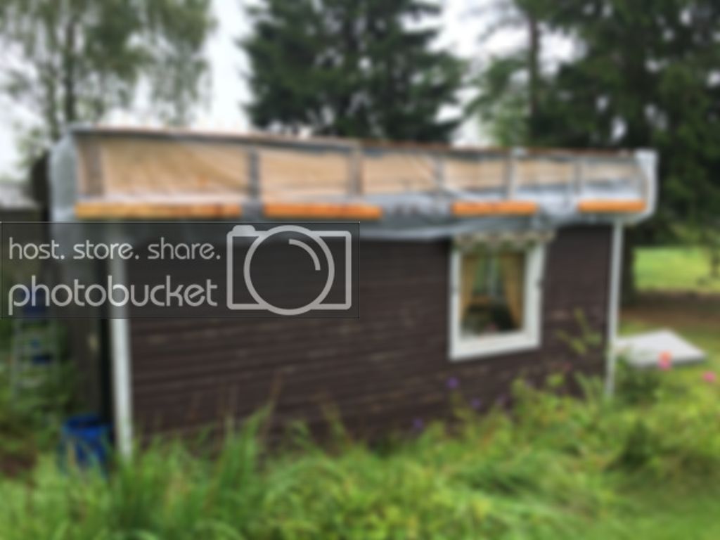

Huset i sin helhet
![IMG_2708_zpslztonesv.jpg IMG_2708_zpslztonesv.jpg](/forum/proxy.php?image=http%3A%2F%2Fi126.photobucket.com%2Falbums%2Fp117%2Fterrariehobby%2FFotskal%2520husprojekt%2FIMG_2708_zpslztonesv.jpg&hash=f32d3acaa52e646ed1f2bd10ad54fdeb)
![IMG_2709_zpsur2nh6nn.jpg IMG_2709_zpsur2nh6nn.jpg](/forum/proxy.php?image=http%3A%2F%2Fi126.photobucket.com%2Falbums%2Fp117%2Fterrariehobby%2FFotskal%2520husprojekt%2FIMG_2709_zpsur2nh6nn.jpg&hash=c14f46ff3833da83a1b933902e4f36b3)
![IMG_2710_zpsyyrjv0b5.jpg IMG_2710_zpsyyrjv0b5.jpg](/forum/proxy.php?image=http%3A%2F%2Fi126.photobucket.com%2Falbums%2Fp117%2Fterrariehobby%2FFotskal%2520husprojekt%2FIMG_2710_zpsyyrjv0b5.jpg&hash=c0937d7aabdcbf8b59ae07148a4983cb)
![IMG_2711_zpsu3ihjcmw.jpg IMG_2711_zpsu3ihjcmw.jpg](/forum/proxy.php?image=http%3A%2F%2Fi126.photobucket.com%2Falbums%2Fp117%2Fterrariehobby%2FFotskal%2520husprojekt%2FIMG_2711_zpsu3ihjcmw.jpg&hash=025b3645f25a34e84d4e85aa701fc958)
![IMG_2712_zpsv6b8o3n8.jpg IMG_2712_zpsv6b8o3n8.jpg](/forum/proxy.php?image=http%3A%2F%2Fi126.photobucket.com%2Falbums%2Fp117%2Fterrariehobby%2FFotskal%2520husprojekt%2FIMG_2712_zpsv6b8o3n8.jpg&hash=9df7ccea76a9cb51abdb1d8dc25537a8)

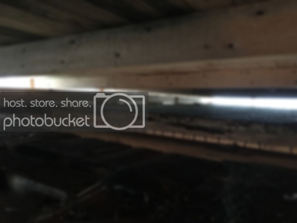

Rivning av gamla yttertaket
![IMG_2491_zpseb1atyn4.jpg IMG_2491_zpseb1atyn4.jpg](/forum/proxy.php?image=http%3A%2F%2Fi126.photobucket.com%2Falbums%2Fp117%2Fterrariehobby%2FFotskal%2520husprojekt%2FRiva%2520gamla%2520yttertaket%2FIMG_2491_zpseb1atyn4.jpg&hash=233aa1fb652abb5f355f1c001fc66a8d)
![IMG_2493_zpstuvnkppj.jpg IMG_2493_zpstuvnkppj.jpg](/forum/proxy.php?image=http%3A%2F%2Fi126.photobucket.com%2Falbums%2Fp117%2Fterrariehobby%2FFotskal%2520husprojekt%2FRiva%2520gamla%2520yttertaket%2FIMG_2493_zpstuvnkppj.jpg&hash=332ef88f79a458f21aad5dd0c5d8bd58)
![IMG_2494_zps1j9p728t.jpg IMG_2494_zps1j9p728t.jpg](/forum/proxy.php?image=http%3A%2F%2Fi126.photobucket.com%2Falbums%2Fp117%2Fterrariehobby%2FFotskal%2520husprojekt%2FRiva%2520gamla%2520yttertaket%2FIMG_2494_zps1j9p728t.jpg&hash=10d799fb9367b72c4ef826f5964e3507)
![IMG_2703_zpswenu9tfn.jpg IMG_2703_zpswenu9tfn.jpg](/forum/proxy.php?image=http%3A%2F%2Fi126.photobucket.com%2Falbums%2Fp117%2Fterrariehobby%2FFotskal%2520husprojekt%2FRiva%2520gamla%2520yttertaket%2FIMG_2703_zpswenu9tfn.jpg&hash=2a5c091f2b7ae4e469786f854842ecee)
![IMG_2704_zpsbkbmsqna.jpg IMG_2704_zpsbkbmsqna.jpg](/forum/proxy.php?image=http%3A%2F%2Fi126.photobucket.com%2Falbums%2Fp117%2Fterrariehobby%2FFotskal%2520husprojekt%2FRiva%2520gamla%2520yttertaket%2FIMG_2704_zpsbkbmsqna.jpg&hash=0eef667573fdba37bf54fc264b63ae79)
![IMG_2705_zpstlpfhmq2.jpg IMG_2705_zpstlpfhmq2.jpg](/forum/proxy.php?image=http%3A%2F%2Fi126.photobucket.com%2Falbums%2Fp117%2Fterrariehobby%2FFotskal%2520husprojekt%2FRiva%2520gamla%2520yttertaket%2FIMG_2705_zpstlpfhmq2.jpg&hash=791d5c19e5138e2fa1d3c078563aefa4)
![IMG_2706_zps80odcldh.jpg IMG_2706_zps80odcldh.jpg](/forum/proxy.php?image=http%3A%2F%2Fi126.photobucket.com%2Falbums%2Fp117%2Fterrariehobby%2FFotskal%2520husprojekt%2FRiva%2520gamla%2520yttertaket%2FIMG_2706_zps80odcldh.jpg&hash=06df39e55306f254399eef0d640f2e85)
