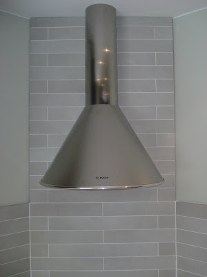

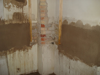

Samma hörna
![DSC07088.JPG DSC07088.JPG](/forum/proxy.php?image=http%3A%2F%2F4.bp.blogspot.com%2F_v1anL0iZ_bs%2FStSKLUucTdI%2FAAAAAAAAANc%2FO8H6UubZlNw%2Fs400%2FDSC07088.JPG&hash=dffab486915995c94461999d18010910)
![DSC07937.JPG DSC07937.JPG](/forum/proxy.php?image=http%3A%2F%2F4.bp.blogspot.com%2F_v1anL0iZ_bs%2FS4I6q7lYb_I%2FAAAAAAAAAqI%2FZ-2trW4m75U%2Fs400%2FDSC07937.JPG&hash=34c907693b8a4362455ed0523fba4474)
