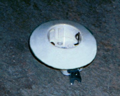

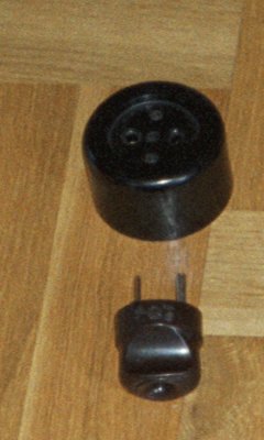

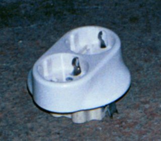

Tycker faktiskt att "stilen" på renova kan hittas på dessa gamla uttag, inte detaljutförande men form...

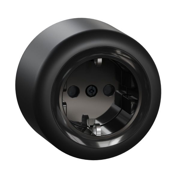

Renova:
![218280-44-renova-2-vags-uttag-schneider.jpg 218280-44-renova-2-vags-uttag-schneider.jpg](/forum/proxy.php?image=https%3A%2F%2Fwww.elbutik.se%2FPICTURE%2F218280-44-renova-2-vags-uttag-schneider.jpg&hash=fb3bf0fb78000bbb020b808afb9588de)
![177936-44-renova-vagguttag-1-vags-1831177.jpg 177936-44-renova-vagguttag-1-vags-1831177.jpg](/forum/proxy.php?image=https%3A%2F%2Fwww.elbutik.se%2FPICTURE%2F177936-44-renova-vagguttag-1-vags-1831177.jpg&hash=f2e3b92265bd49a5e60a867332da8f3f)
http://www.elmuseum.se/?/uttag.htm
http://home.swipnet.se/elsamling/strombrytare.htm
![uttag_jordat2.jpg uttag_jordat2.jpg](/forum/proxy.php?image=http%3A%2F%2Fwww.elmuseum.se%2Fimages%2Futtag_jordat2.jpg&hash=5b6485c40e0579f6c25db5b037177d34)
![uttag_jordat1.jpg uttag_jordat1.jpg](/forum/proxy.php?image=http%3A%2F%2Fwww.elmuseum.se%2Fimages%2Futtag_jordat1.jpg&hash=4b3404f15560ebac480c0295297f6701)
![uttag_alpha.jpg uttag_alpha.jpg](/forum/proxy.php?image=http%3A%2F%2Fwww.elmuseum.se%2Fimages%2Futtag_alpha.jpg&hash=fd6788b2b64b65b29afcab39062b164d)

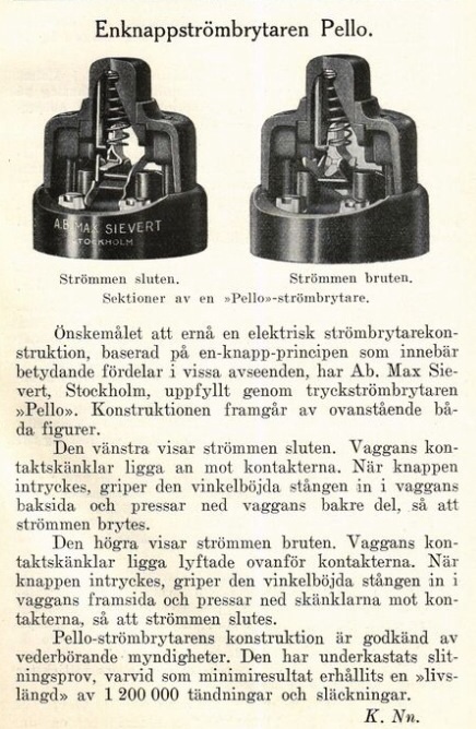

Om Pello;
![image_2014-01-03.jpg image_2014-01-03.jpg](/forum/proxy.php?image=https%3A%2F%2Ffluxio.se%2Fmedia%2Fkunena%2Fattachments%2F301%2Fimage_2014-01-03.jpg&hash=dabdc064535062ade148ac4d492514b4)
